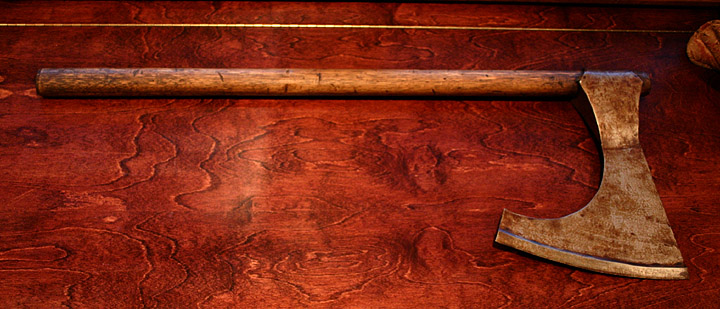

Hello all, and Happy Holidays!
Here is my first attempt at antiquing (ala Sean Flynt). It's Albion's Bearded Axe mounted on an old hickory handle I found. I used the vinegar and salt treatment he described as well as the walnut stain and sanding on the handle. Whajja think?
However, the handle, being straight, and just a teensy bit small for the axehead, needed to be shimmed with wood. Is this an authentic way to attach it? Or would they drive a metal wedge into the end of the handle? Or drill a hole through the side and rivet it? Or even wrap the head with leather straps? For some reason the wood shims work themselves out every once in a while and I need to tap them back in. Anybody who knows what the best "historically correct" method of attachment please let me know!
Thanks in advance!
Scott

Looks great to me, man. All of the ways you just described to attach the handles are okay, I guess. The way I have seen a lot of tomahawks and small axes done is by inserting the handle through the top of the head, then beating it on. The handle would be tapered....slightly smaller at the grip end than where it meets the head. This would make the handle actually tighten up the more you swing it and chop with it. I'm sure, though, that in ancient times the heads of axes were attached all of those ways. Hasty battlefield repairs might see them held together with most anything. I use the salt and vinegar soak to age blades and stuff too. It works really well to actually bury the piece in the dirt, then soak it over a period of time. I wouldn't ,however, suggest doing this to an Albion Next Gen or anything. I use that method only to age bare blades, and I wrap the tang in duct tape very well. Dang........I gotta get you guys some pics of some of the stuff I've made! It may be crappy looking to y'all, but I'm proud of 'em. Anyway, good job! mcm
Posts: 1,757 Location: Storvreta, Sweden
Sat 11 Dec, 2004 3:28 am
An authentic way to affix the blade to the haft is to cut to slits halfway down the part of the haft hidden in the head.
The two slits should be cut like an X. One aligned with the grain (going i the direction of the edge of the axe) and the other slanting across this.
Sometimes I have seen small iron wedges sitting in the rust inside the eye of vikig axes.
You could use one wedge of wood and the second wedge of iron. The last wedge would then seal the binding.
This method works best of there is already a decent fit between haft and axe eye.
I do not think viking axes were affixed the same way as Tomahawks and hatchets. The eyes are generally too small to allow for the haft to be even smaller. Some axe heads have more generous eyes, but I think the same method was used in most cases.

Another question occurred to me... I was wondering if the handle would've been wrapped in leather. Are there any surviving axes with handles from this period?

My question still stands for all you Viking experts out there--- Would the handle be wrapped in leather? And if so, what would the pattern be?

I do not think the handles were wrapped in leather, but I have no proof they were not.
To me it seems "out of character", but you never know...

I'm just back from Riga and visited the history museum of Latvia there - look what I found! :) Unfortunately they had no signs whatsoever in english, but the axe was in the part of the exhibition I'd date to late Iron age. It sure looks like a hand axe-haft wrapped in leather and I've never seen anything like it. The latvian soil seems to be gentle on organic stuff - they even have a round iron age shield on display.
Sorry about the crappy picture, I wish I had a better one. The edges of the the strip of leather had a row of small marks - probably a decoration.
Attachment: 123.09 KB
Here it is. [ Download ]
Sorry about the crappy picture, I wish I had a better one. The edges of the the strip of leather had a row of small marks - probably a decoration. |
The haft is so much better preserved by the head (at least the leather cover) that makes me want to say that is was added to the head AFTER the head was excavated.
I could be wrong though.
Alexi

Thanks Petri!
This was what I was wondering about! That's the first example I've seen. Thank you again.

Wrapping handles would seem to me an obvious thing to do even if proof of it being done seems very hard to find.
I assume that wrapping axe handles improves your grip and can also help keep the handle from splitting or keep it together if a spilt occurs.
Now take the case of having your axe handle break or splitting along the grain: Wouldn't using leather or cord make it usable again ? Let say an axe handle were wrapped with cord over it's entire length before it even broke: Taking up a lot of the stress of the chock of heavy blows. (Wouldn't this increase the usefull life and strength of the handle ? )
Now with so few surviving examples knowing what practical or decorative pattern were used becomes the question ?
