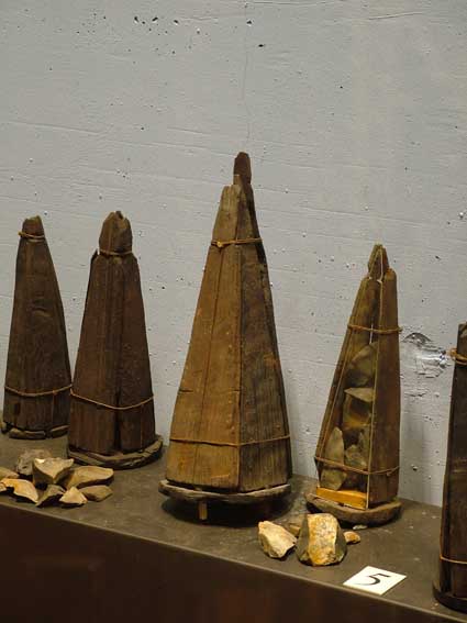

On the subject of historical evidence, we do have surviving examples of medieval "canister shot" consisting of a wooden container filled with small rocks:
^Not my picture. But the ones I saw on display next to the Loshult gun in Stockholm were around 2 or 3 inches in diameter, so not really musket-sized, but perhaps small enough to be fired by something technically considered a "handgun".
Many of the individual stones themselves were definitely small enough to be fired out of a musket if you really wanted to.
