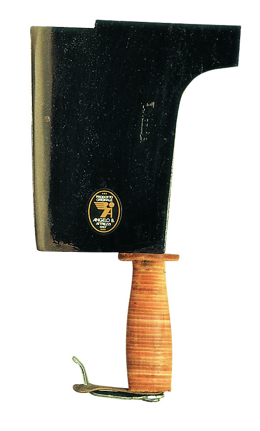

Very nice thread you did there! Apparently, there is a modern form of the cleaver-shaped beidana, which is called manaresso in Italy. Those are used like machetes or billhooks, but can be used in the kitchen as well. There is many variations in Northern Italy (like billhooks here in France) :
Piemonte
Reggio Emilia
Bologna
Brescia
Santa Giustina
And so on...
Now, let's take a look at this. It was my grandmother cleaver, and very highly possibly my great-grandmother one too. It is quite the same shape, except for the classic "french handle" in place of the traditionnal italian one. The dimensions of the blade and weight, and even the blade thickness seem to match with, for example, the Brescia Manaresso. It is freaking huge, and the blade and edge are so tough that I'm sure that it can be used as a billhook if you need.
I guess that back in the days in the coutryside, and perhaps even today, many objects were not so specialized and could be used at various tasks.
