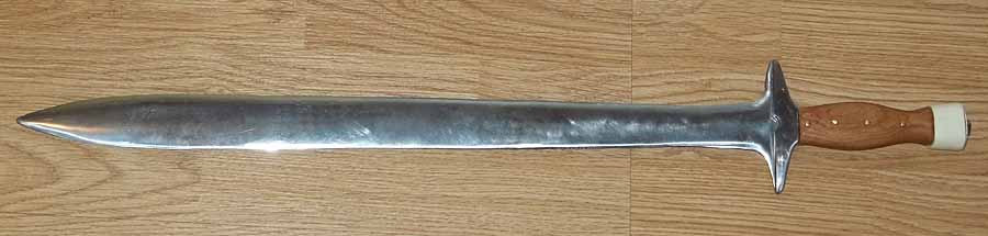

This is what I did to the older Deepeeka xiphos:
Still have to do the scabbard for it, but you can see others that I've done on my Hoplite Weapons page,
http://www.larp.com/hoplite/greekweapons.html
