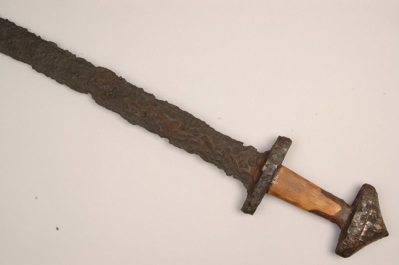

No, not all swords had roundish or fatty tips, especially not those from Sweden during the later part of the Viking age.
Here's a narrow thick bladed Viking age sword with no apparent fuller found near Adelsö (near Birka).
Link to the Kringla website:
http://www.kringla.nu/kringla/objekt?text=sv%...ect/263029
It seems to me a sword like this would be well suited for thrusting and could be quite rigid.
