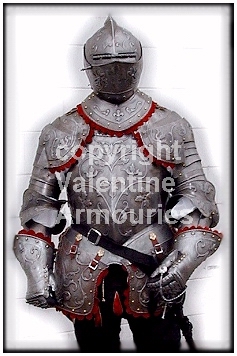

http://www.arador.com/gallery/friend3.jpg
http://2.bp.blogspot.com/-PwjeSvMEX2E/Ty9n1fO...0_4565.JPG
http://www.artic.edu/aic/collections/citi/ima...330030.jpg
http://www.varmouries.com/cgallery/arch_09a.jpg
Could I make the argument that this was the battlefield armor with combinated tasset plate (replacing the thigh plates) and knee plate?
http://historicalarmouries.webs.com/photos/Knight_G_Gallery-1.jpg
Or could I simply add the leg harness (thigh plates and knee plates) shown in these portraits?
I am aware that the strapping is different but it is what I am looking for.
William P: I am not looking for Maximillian armor, just a simple late 16th Century Half-Harness. Although you're right with its popularity.
David E: I am not looking for etching on my armor, just simple armor.
I appreciate the feedback and I will give what I am looking for here. I have given you the historic examples and I will show what I am looking at.
(the pauldrons will not have the hault guards)
Now one of my earlier questions was this, is it necessary to add the leg harness?
I hope this helps on my part and I welcome the feedback, suggestions and recommendations.

A pair of 16th century harness that dont appear to have been designed for courtiers or are field as opposed to tournament armour. much plainer with less decoration.
First missing its helm here but will all original pieces and more modern leg armour
second with some more modern replacement pieces based of damaged originals. older style leg armour.
nether harness had gauntlets that i know off.

The other question that I have is this: Is it ok to add the tassets to the Peascod Breastplate or would that change the historical accuracy of the Hard Kit? Or what I am trying to say is that would adding tassets make my Kit a decade late or earlier?
Thank you for the input, advice and help, most appreciated.
I'm glad to hear you're taking this stuff into consideration. Authoritatively speaking to and teaching groups as you intend to about factual history isn't served by fantasy costumes ;) I think the stuff we linked to is mostly in the range of being much more affordable than the stuff you posted initially, so I hope that helps your budget. All that said, unfortunately, what your presentation and portrayal need may not match up with what you pictured in your head initially.
I'm sure someone will answer your tassets question soon. I think it'd be fair to say that many sets had tassets, but I'll let someone with my knowledge of armor tend to a definitive statement
If your budget is tight. Then Tudor Tailor and Ninya's patterns. can't go wrong with them... :-)
Tassets. If doing a posh end armour, yes, as per the various portraits and pictures supplied. But short for fighting on foot. The knee length stuff is for Horse so avoid unless you can splash out for the horse, the right saddle and all the bits. The style of armour affects the date not the bits added to it.........unless you start wearing a Great Helm ;-)
Historically. The English loathe excess weight so tassets, pauldrons, vambraces and all those bits get binned, along with the burgonnet. They'd much rather wear a tasy little number in a Morrion, much to the disgust of Sir John Smythe. Arming doublets disappear as doubets tend to be lightly padded anyway and armour is very frequently linned with leather, linen canvas, buckram and sheep's wool for padding. Leather jerkins appear and "may" be being used to secure armour to........whilst also being worn as armour in it's own right, and that's Buff jerkins, not 2mm thick glove leather. Buffcoats appear, with the first reference being in 1600 in Ireland.
Mail sleeves are reserved for Light Horse so are out of the question, regardless of Smythe's blowhard ideas........
You can do a decent English impressed soldier from about the mid 1580's quite well and the info is out there.....and it's not going to cost quite so much in fripprey.........

Quote: |
Tassets. If doing a posh end armour, yes, as per the various portraits and pictures supplied. But short for fighting on foot. The knee length stuff is for Horse so avoid unless you can splash out for the horse, the right saddle and all the bits. The style of armour affects the date not the bits added to it.........unless you start wearing a Great Helm ;-) |
I am doing Posh End Armor, my goal to create a half harness designed for fighting on foot, so would longer tassets be needed?

Right. This is were Posh end armour actually works out better for the reenactor for a change.
The bad news is that if you're looking at depicting Tourney, the armour really MUST include etching. Tourney at this stage is as much about showing off bling as it is about fighting.....
BUT. That's not totally bad news as you don't need to buy every piece at once. At heart you need back and breast, gorget, burgonet and falling buffe. Tassets are going to be short for fighting on foot and you can then add the extra pieces to cover to the knees later. If you look at the first armour shown above you can see the that th elegs are covered by two pieces of armour. The arms will need to be covered by pauldrons, vambraces and gauntlests. And you'll need an arming doublet to point them to.
If you avoid Tourney then you can avoid etching.....and can swap mail sleeves sown to the sleeves of the arming doublet but still need gauntlets.

I see, I am beginning to understand the differences and I find it helpful.
Now with me understanding this, allow me to ask these questions.
Since I am attempting to recreate a Tudor Knight in the battlefield, do I need voiders for the arm pits and elbow joints or would the mail sleeves pointed to the arming doublet be fine?
Is it necessary to not add the tassets or the leg harness or would that change the design of the harness from battlefield to tourney?
I am seeking for a half harness (helmet, gorget, breastplate and backplate, arm harness, gauntlets) would the tassets and leg harness be a trivial addition or am I better off with the original design.
I may be repeating the original questions, but when I have the budgetary means to invest in the Soft Kit, this will help me in determining the accurate pieces.
