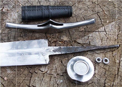

Yeah, the tangs look like this on the darksword knight:
http://www.sword-buyers-guide.com/images/darksword-tang.jpg
Near as I can tell, that is the one second from the right on this chart:
http://www.albion-swords.com/images/functiona...ethods.jpg
For comparison, I believe Albion uses the hot peened type, which is all the way to the right. Even Cold Steel uses the middle two. I wouldn't own or use a darksword if they payed me.
Feel free to base your decisions any way you like, good sir.
Nicholas Maider wrote: |
For comparison, I believe Albion uses the hot peened type, which is all the way to the right. |
Albion does use the one to the far right, but that tang layout can be peened hot or cold. Just using that layout doesn't mean it has to be hot-peened. After all, how can you tell if that diagrammed assembly uses heat? :)
