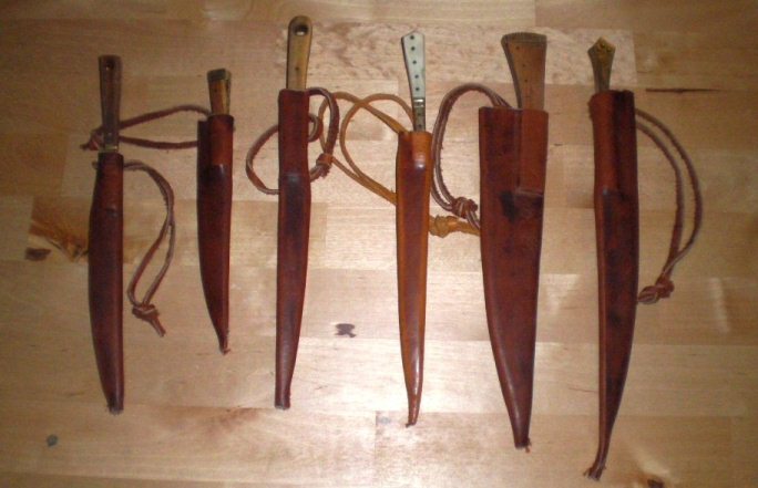

Another batch of medieval knives reproductions... They are not perfect, but it was fun making them.
They have usual construction, with riveted handles made of brass combined with bone or wood.
(Sorry for crappy pictures, I shall make some fotos during daylinght.)

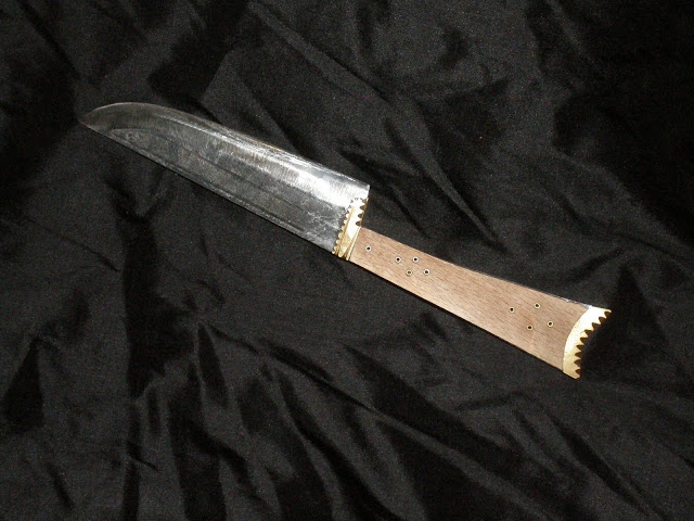

...and here is another one, just finished. It is my first "serious" attempt for a tang construction. Handle is a combination of brass, bone and rose-wood.
Doing this project, I have stumbled onto one problem: how to cold-peen the tang, without damaging the blade? The best I came up with was wrapping the blade in a sheet of paper and clawing it really hard in a vice. Is there possibly a better method? Any advice appreciated... thanks.

Dustin R. Reagan
Joined: 09 May 2006
Posts: 264
PostPosted: Wed 19 Dec, 2012 2:32 pm    Post subject:         Reply with quote
Nice knives! They look like they came straight out of the river Thames! =]
Really, i think you nailed the handle construction dead-on on a lot of those knives (I especially like the really skinny, delicate handles).
A couple options for holding the blade in a vice without damage:
-Leather-faced jaws.
-Brass, Aluminum or Lead inserts for your vice jaws (basically any soft metal).

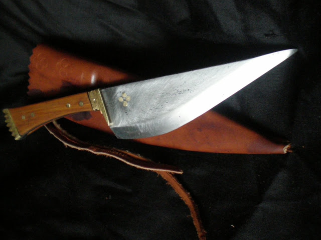

Dear all, let me contribute with my latest creations. The first one is a large cooking knife. It still needs some polishing on its blade, and I will probably re-shape the handle - so please take it as a work in progress:)
The second one was for my fiend´s birthday. I wanted to make it more special (and try a new technique), so it has a brass inlay work on its blade. It´s not perfect, but I´m rather happy with the result.

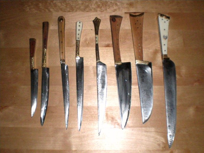

After a while I managed to finish two more knives. The first one is a slender eating knife, inspired by some 15th cent German examples, with full-brass scales. The method was rather un-sophisticated (scales are riveted, not soldered), but I more or less like the result.
The second one is a larger eating knife, with brass and horn scales and some brass decoration. Here I´d like to ask for your advice: how would you polish horn to a high gloss? I was working with a sand paper, but achieved only this "satin look". Thanks in advance...

Tjarand Matre
Location: Nøtterøy, Norway
Joined: 19 Sep 2010
Posts: 159
PostPosted: Mon 06 May, 2013 1:29 am    Post subject:         Reply with quote
Really nice details!
Justin King
Location: flagstaff,arizona
Joined: 12 Apr 2004
Reading list: 20 books
Posts: 551
PostPosted: Mon 06 May, 2013 5:56 am    Post subject:         Reply with quote
Horn finishes well with sandpaper and steel wool, I usually sand to about 600p and then polish with 000 steel wool. Very nice work by the way!

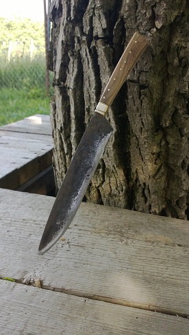

...and here´s another one. this time a larger cooking knife.Shape was inspired by some 15th cent. artwork.
The blade was made from a scrap piece of rusted metal, which was probably a broken blade from grass-cutter. I found it laying in the corner of our garden. I have cleaned it chemically and mechanically, but it still retains a "rustic look" (I know that it´s often just a code-word for "not very well-kept" Happy)
The scales are from brass and elm, riveted by solid brass rivets. The knife still needs a sheath, but it will have to wait for a smaller brother, to make a nice cooking-set. All comments and criticism are welcome.

PostPosted: Sun 19 Jan, 2014 2:51 am    Post subject:         Reply with quote
Was browsing around for your past work Radovan and I think it's really excellent. You have an eye for eating knife design for sure.
It's funny because I recall you said on another of your topic that your work was amateurish (found it: "I have to stress that it´s just very amateurish, learning by doing exercise"). Well you, lean fast! so I really don't agree as the above knives tell me otherwise. Your Bauerwehr makes the point even more. They also tell me you are comfortable with most of the techniques needed to achieve a pro level project (pinning, riveting, cutting and shaping a blade, heat treatment).
The one thing that is a bit of a let down is your finish (blade and sometimes the sides of your wooden handle are a bit rought), which is really awkward as it is the easiest part really. It looks like you are in a hurry to finish Happy Granted finishing is often very boring but well worth the effort. You work mostly with an angle grinder, and it leaves grinding marks.
Short answer: you need a belt grinder. I have no room for a backstand at present, but I am finishing blades and hilt components with a small 20£ aldi hand held belt sander, that has attachments to clamp it on a workbench belt facing up. I thought little of it when I bought it when grocery shopping, but I would be unable to complete most of my projects without it. I just bought quality belts on ebay, grit 40 would deal with those grind marks with little efforts. It has variable speed. Now this piece of equipment would make any professional blade smith have a good laugh, but what the hell - it does the job. I've done scabbard cores with it, shaped mild steel guards (angle grinder+this to refine and finish).
Sandpaper also does the trick, but will take more efforts. I use sanding sponge preferably, they speed up the work.
Otherwise clamp you blade on a long wooden slats that will extend beyond your workshop. Use double side adhesive to secure your sandpaper to a piece of hard wood that you will hold with both hands pressing on your blade. Then back and forth with a little oil...boooring yes. but this will work Happy
Hope the above will help. In any case I'll follow your projects with great interest.
