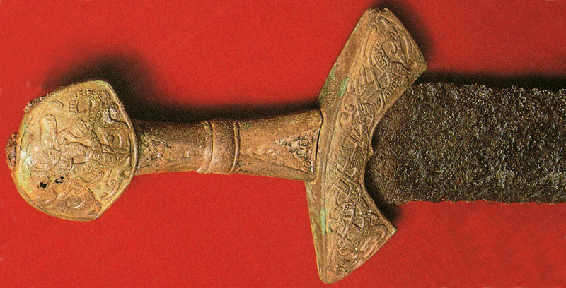

Btw, here are the two swords with entirely bronze hilts. Unfortunately the second has only the upper guard survived and the pictures are black and white.
![Photobucket image](http://myarmoury.com/images/pb/img.php?i=http://i153.photobucket.com/albums/s236/lukaborscak/ptsnf080.jpg)
![Photobucket image](http://myarmoury.com/images/pb/img.php?i=http://i153.photobucket.com/albums/s236/lukaborscak/ptsnf081.jpg)

Let us not forget this example....
