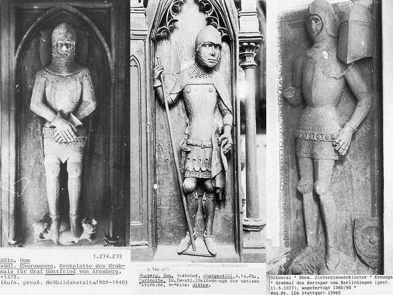

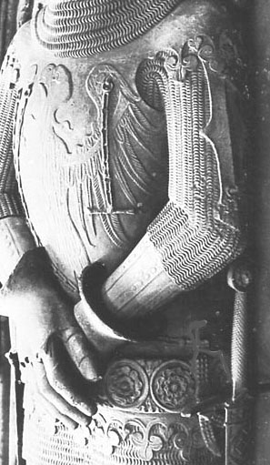

I'm hoping to start another discussion about armour.
Attached are three different armours.
What can you tell me about them? How would you identify them? What are each called? What similar examples of each can you find in period art or surviving samples?
A close-up of the first one (on the left) is included with more detail.
Museum info is included under each one.
Thank you.

PostPosted: Sun 26 Nov, 2006 1:23 am    Post subject:         Reply with quote
Nathan,
Number one looks to be wearing more or less full plate arms and legs except his greaves may be shynbalds and the rerebraces may only cover the outside of his arms. He likely is in a Coat of Plate but could be a solid breastplate undefined. He wears a bascinet.
Two is about the same but looks like he has fully encompassing armour for his limbs. His torso armour looks more defined than one but hard to tell.
Three is about the same but has a breastplate on, the medial ridge is fairly clear.
They all have at least one chain on there torso defence, all have what looks like hourglass gauntlets, some with fingers. Also all wear bascinets. They all seem to have mail skirts (perhaps not 3) but the 3rd has a coat of plate style skirt.

PostPosted: Sun 26 Nov, 2006 7:19 am    Post subject: Armour         Reply with quote
I had a chance to look at no 1.......he appears to be wearing a maille hauberk with an unusual shaped edge which is pointed in the middle. After blowing it up, I could see that to me he appears to have a solid fabric-covered breastplate which has three chains...one for the sword, one for the dagger and the third has a toggle on the end, which I assume, would have slipped through a ring on his shield. I know it was fabric covered because you can see the ornate and unusual dagged edge which continues and hangs just below the belt. He also appears ( after twinking the image-contrast and brightness) to have rather ornate Jack-Chains over the long sleeves ( easier to see on the right of the pic) The sleeves seem to suggest a padded Gambeson with vertical stripped padding-seams worn over the haberk. Under the maille coif hangs the edge of a matching dagged edge of a coif-lining. There also seems to be some sort of lower vambrace section near the gauntlets.
Its very late here right now, but I have done some close-ups if anyone wants to see them.
Tomorrow I'll check out the other two...........very interresting !
Cheers.
Merv ....... KOLR

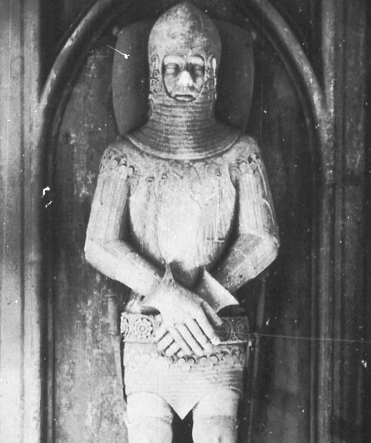

PostPosted: Sun 26 Nov, 2006 5:32 pm    Post subject:         Reply with quote
Thank you for the responses so far.
Here is another view of the first image.
 Attachment: 96.65 KB
PostPosted: Sun 26 Nov, 2006 6:00 pm    Post subject:         Reply with quote
The pointed hauberk/haubergeon on #1 is actually not that uncommon, especially on German brasses. Several effigies/brasses in this book ( http://www.myArmoury.com/books/item.php?ASIN=048643740X ) show them. I imagine they'd offer a little extra protection to sensitive places, especially when mounted.
The "jackchains" on #1 are really just rudimentary plate arm defenses, not really the later arms defenses we call "jack-chains." His vambraces look to be splinted.
To me, it looks like good olde transitional harnesses, with various stages of development. Happy Cool stuff, for sure.

PostPosted: Sun 26 Nov, 2006 8:45 pm    Post subject: Gottfried von Schnoodlefrappen         Reply with quote
Thanks Nathan.............er, you wouldnt happen to have the lower half of him lying around anywhere would you ? I mean the horizontal effergy shot. This is a very interresting harness and right in our groups time period too.
Thanks.
Merv ....... KOLR
PostPosted: Sun 26 Nov, 2006 8:48 pm    Post subject: Re: Gottfried von Schnoodlefrappen         Reply with quote
Unfortunately, that's all I've got.

PostPosted: Sun 26 Nov, 2006 9:20 pm    Post subject:         Reply with quote
Re Harness No 1....
When I blow this up, it looks to me like the maille sleeves are flush with, and may join onto the splinted vambraces ?
I havent seen this before. What do you think....the maille appears on the same level as the splints ?
Also.......on the breastplate coat of arms, if you were to kinda cut out the Prarie-Chicken in the middle and then shove the two wings together, then you'd sorta end up with my mothers family arms seen here on the left Avatar Icon.
( Seymour = St. Maur ) Sir Wiilliam de St. Maur came over with William the Conqurer and started most of the Seymour family in the UK. He was the first Norman Knight to get a land grant in Welsh territory at Penhow Castle which you can see on the internet ... http://www.castlewales.com/penhow.html and still visit to this day. So when I finally make a harness for myself, this example interrests me as it is also in a good period fot our reenactment group... http://www.lionrampant.com.au/
Cheers !
 Attachment: 50.18 KB
Merv ....... KOLR

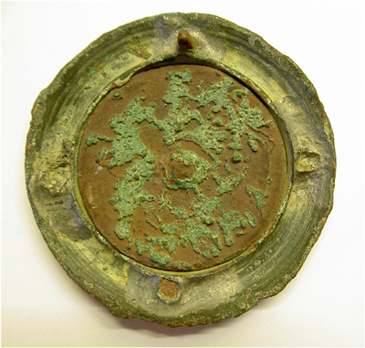

Very Interesting topic. Thought you may be Interested to see a Item I found some years ago when out metal detecting.
Doing some research I found an article about an area were said may have been used jousting, I searhed a very large area and over a couple of years found many hammered silved coinage from the 13th- 14th century but no Items of armour buckles etc but did find the enclosed picture of a mount I found. I took this to the Museum and after waiting was told It was a " Mount off a knights belt " ( compare with other pic`s ) I have a museum write up on It but at the moment cant find It, It was named The Litterbourne Belt Mount.
Difficult to see on the picture but there Is remains of enamel and gold guilding.
It is made of bronze, 2 inches diameter.
Thanks Tony.

Tony,
Thats pretty cool. It is always fun to find these connections with arch objects and contemporary accounts

Hello again!
This is what Hefner-Alteneck said about Gotfried, Count of Arensberg. Take the info with a grain of salt, since Hefner-Altenenck was a nineteenth-century historian, but I'm presenting this information as-is because something useful may be gleaned from it:
J.H. Hefner-Alteneck wrote:
Gottfried, Count of Arensberg
d. 1370
Burial monument. The knight's leather surcoat shows the Arensberg coat of arms, an eagle. Iron strips have been added to reinforce the mail of the upper arm as well as the lower leg. On the upper arm, the strips are attached to the mail with small straps, which can be seen under B. Armour for the back of the legs is made of leather and can be seen at D, along with an iron poleyn that protects the knee. Arensberg's surcoat has three chains for attaching a great helm, dagger, and sword. C shows a portion of the belt with a sword strap wrapped around it. shows the manner in which the aventail is attached to the helmet. E and F show the right heel with spurs, pictured from both sides.
Sorry again about not being able to post the pictures (my scanner has annoying limitations), but this gives you the basics of how Hefner-Alteneck interpreted the armour. I think the artist just cut corners and didn't sculpt the mail on the backs of the leg, since the backs of the legs appear smooth. I don't think Hefner-alteneck's interpretation of leather on the backs of the legs is accurate. I also see no reason to suspect that the surcoat is leather, it was more likely cloth. The arms are attached with laces, or "points", not straps. Still, his drawing was very accurate (it matches the photo Nathan posted).
Prince Andrew of Armar
View user's profile

James Arlen Gillaspie
Location: upstate NY
Joined: 10 Nov 2005
Posts: 587
PostPosted: Mon 27 Nov, 2006 6:26 pm    Post subject:         Reply with quote
Merv, I've seen the Arensberg effigy and the mail sleeves are not quite at the same level as the lower cannons. It looked to me like the artist wanted to show the sleeves as tight but pulled over the cannons. Hefner-Altenek might have thought the 'coat of arms' needed to be leather to help explain the trefoil ornaments around the edges. I too think it most likely was textile, but something is certainly going on there.
jamesarlen.com
Last edited by James Arlen Gillaspie on Mon 27 Nov, 2006 6:33 pm; edited 1 time in total
Jared Smith
Location: Tennessee
Joined: 10 Feb 2005
Posts: 1,532
PostPosted: Mon 27 Nov, 2006 6:31 pm    Post subject:         Reply with quote
The first thing that comes to mind for me is that is all appears to be "transition era" armour. I suspect all of them have mail underneath partial plate and are early 14th century. The rounded great helm fits this era as well. Without color, the photographs are pretty hard to judge.

-Two German knights from the early 15th century Zeischrift fur historische Waffenkunde. Their sword belts are also decorated with a single row of round disks or spots.
-The knight from the tomb of Du Guesclin (1360-1410). What may be the shield's guige strap sports what appear to be round disks rivetted on, in a single row.
There are also some civilian belts decorated in similar fashion from the same source:
-On the plate with a figure from a tympanum in the Tyn Church in Prague, there are shown details from civilian girdles. One is decorated with a series of small studs or rivets arranged in almost an "arrow-head" or sideways chevron design. Other girdles show rosette or trefoil plaques interspersed with pairs of "studs" or small spots.
None of these are the "belt of plaques" so popular in the late 14th century; there are many "belts of plaques" depicted in figures in the same source, and they are obviously made up of plaques. They are clearly different from the "studded belts". Furthermore, must we assume that, since the belts show studs or rivets (sometimes large, sometimes small) that the rivets must have held plates to the back of the belt because they must have done that? Of course not, that's ridiculous!
The fact that there were "nail decorated" garments that may or may not have been considered armour in use in Asia is further proof that men of means could indeed use metallic elements for decoration and not purely function. Many of these garments are highly decorated with nails, but the nails don't hold plates beneath the fabric. The most the nails might function as is to hold the layers of fabric together. I made the argument in a previous thread that roughly similar garments may have been in use in early 14th century England based on a possible interpretation of some of the knightly brasses of that period. Our ancestors did indeed "waste" hundreds of rivets in such a fashion.
