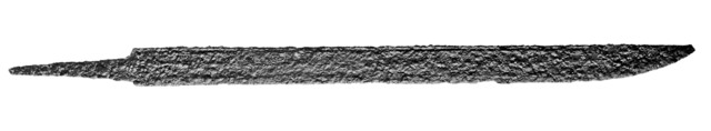

PostPosted: Wed 17 Jun, 2020 12:48 pm    Post subject:         Reply with quote
Check this out. This is a blade from the University Museum of Bergen in Norway. This is from a Viking period grave and was accompanied by other viking grave goods. The narrow fuller is very similar to the blade in question ending before the tip where there appears to be a false edge.
