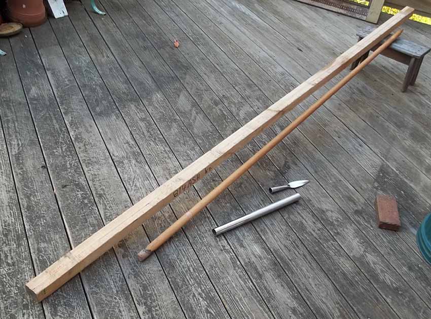

Matthew Amt
Location: Laurel, MD, USA
Joined: 17 Sep 2003
Posts: 1,464
PostPosted: Tue 11 Aug, 2015 7:46 am    Post subject:         Reply with quote
Ah, yes, modern reproduction spearhead sockets are often an inch or more. Originals of that size do exist, but it really looks like the vast majority were smaller. But you need scale drawings or some decent lists of measurements to be sure, and I've never really looked that up for medieval spears.
You *do* want your shaft to fit the head you have! Sometimes you can cut an inch or so off the bottom of the socket to reduce the maximum diameter.
Greek thrusting spears do seem to have been thinner at the point than at the butt. This helped move the balance point as far back as possible. I *suspect* that javelin shafts were the opposite, needing to have their balance point farther forward, and being a little thinner overall. Of course there were also spears meant for both thrusting and throwing, so I can only guess they'd be best with a more central balance point.
Pikeshafts definitely taper, so from my original piece I cut off two tapered lengths. The narrower ends were indeed a bit thin! So I just cut that part off. (The piece was over 10 feet, so I had to lop off 3 or 4 feet in any case.) My two finished throwing spears are about 3/4" diameter at their thinnest. Ah, here--the piece of ash, shown with the regular dowel that I used for the upper half of the pikeshaft:
Then after the first two cuts, the pikeshaft now has the dimentions that I want, and just needs to be rounded. The two "offcuts" are at left, and the wider one will be cut down the middle to make 2 shafts.
Here's the pikeshaft after roughly "rounding" it with the electric planer, and the dowel has been reduced and tapered the same way.
This really didn't take very long! I LOVE my electric planer, but you have to be a little careful with it to avoid going too deep.
Matthew

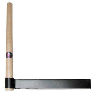

Minor point of order-- you don't split billets of wood with a drawknife, that's not what that's for. You use a tool called a 'froe', or you use a splitting wedge. The froe has the advantage in that by levering its handle back and forth you can direct the split to some degree, a little more predictably than with the wedge. The drawknife is for rough and fast shaping of the blank.
Sawing them out is a bit safer, but obviously won't follow the grain. If you're careful, you can try to follow the grain by eye; some lines drawn along the grain direction can help. Ash (if you're using that, anyway) does have fairly prominent grain lines so that would help.
