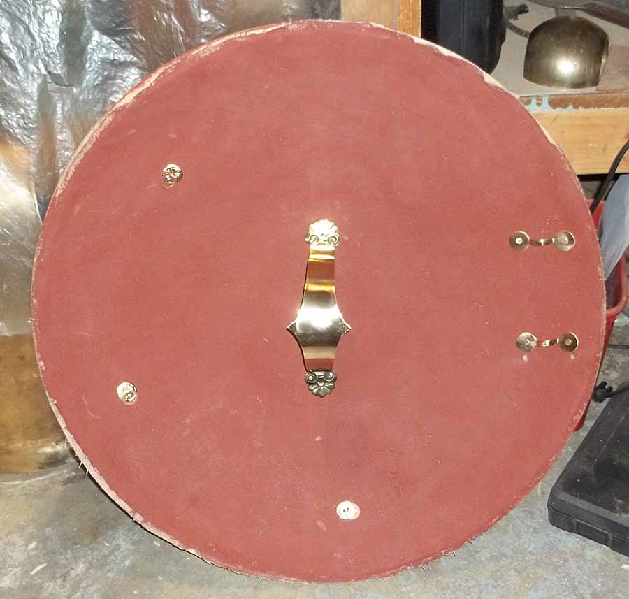

I'm not sure I'm understanding. You're talking about the carrying cord inside the Greek aspis, presumably, as in this photo of mine:
You can't grab the cord with your *own* right hand, since that has a weapon in it! Are you talking about grabbing the cord of someone else's shield? There is no evidence that such a thing was ever done, and not only would it be a tricky thing to do but it would actually limit movement. I wouldn't want to try to block a blow coming from my right and have my shield jerk to a halt halfway because my buddy has hold of the cord! Not exactly the best teamwork.
The aspis is perfectly maneuverable as it is, if it needs to be. You do not have quite the range of motions that you do with a scutum or thureos, of course, but it's more than enough for use in a phalanx. An open melee was an unusual event, but it should never be said that the aspis was "useless" for such work (as I have seen in print!). It's a big shield, works just fine.
Bottom line, the cord is just for slinging it on your back. That works fine, too!

The handgrip (antilabe) on the Greek aspis is separate from the carrying cord. As is often shown in artwork, on my shield the grip is thick and braided, and runs between the two bronze loops. The carrying cord starts and ends at those loops, but is *not* part of the grip itself. It is always shown loose in artwork, so there is never any tightening of it when the shield is carried. With the forearm through the central band (porpax), the inner rim of the shield rests neatly on the shoulder, supporting the weight. The cord is only used on the march, to sling the shield on the back. There are clear vase paintings that show this.
On the other hand, I am currently working on Macedonian shield, which is basically the bowl of an aspis without the flat rim. In this case I will be using the carrying cord to support the shield in combat, since both hands are needed to hold the pike (sarissa). So far I have installed the same sorts of fittings that you see in my aspis, but it may take a little fiddling to get the cord just the right length.
I'm painting it tonight, though, so you'll have to wait for those experiments!
The Roman scutum also had a carrying strap, at least fittings have been found to imply that. But again, that was only for slinging it on the back on the march. In battle, it was held by the single central horizontal grip.
