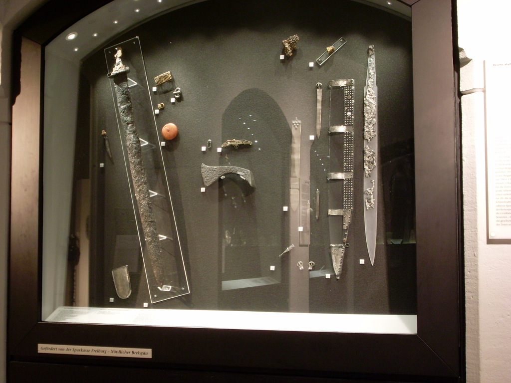

We got a new longseax recently and I've been agonizing over how to sheath it, as the biggest knife sheath mentioned in Esther Cameron's book is no more than 10 inches long. What was your inspiration for this one? I appreciate finds are very thin on the ground, and this one looks so "right".
Thanks Aed!
I must confess I had no information to work from at all, but I nagged Jeroen and Matthew who were very responsive (thanks guys) and was put on to the Stuttgart Psalter and this seax scabbard and as far as they are concerned this is pretty much all the pictorial evidence we have (as I understand it)[/url]

You're welcome Tod (I'll come and see you at TORM and you can give me a manly hug).
Lovely work as ever, I think the hilt is particularly gorgeous.
The only thing that I do different is to follow the Psalter and extend the leather up over the handle, but obviously that doesn't work with one like this where you have a lower guard.
