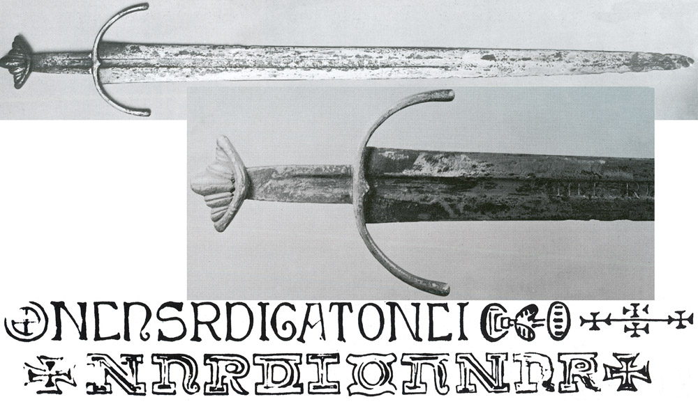

Hi, thanks for the input. I still need a clear drawing that shows the actual inscriptions. Anyone???
Hi Robert...
Here is the best I have... See attachments
Length 95cm
Blade Length 82cm
Max. Blade Width 57mm
Grip Length 85mm
CoG 225mm from guard
Weight 1232grams
Found along Ouse River Yorkshire, near Cawood Castle England
Estimate Date 1125.
Preserved in Yorkshire Museum
Hope this helps some...
take care
ks

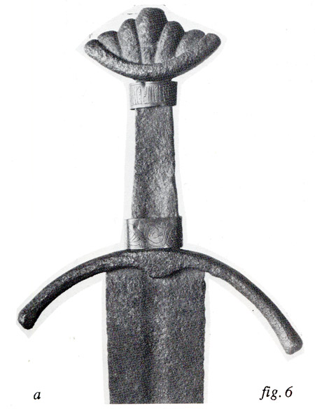

Robert, You can find a detailed description of the sword inscriptions in the appendix of 'Records of the Medieval Sword' by Oakeshott, which is the medieval sword-collector's bible. I now see what you mean about the slight guard asymetry. It's obvious that the other Norwegian sword was made asymetric, but it seems to me from the picture that the Cawood guard might have been bent at some point in time. I think an expert sword maker would have to handle it to be sure.

Also, thanks Kirk, that is just what I was looking for.

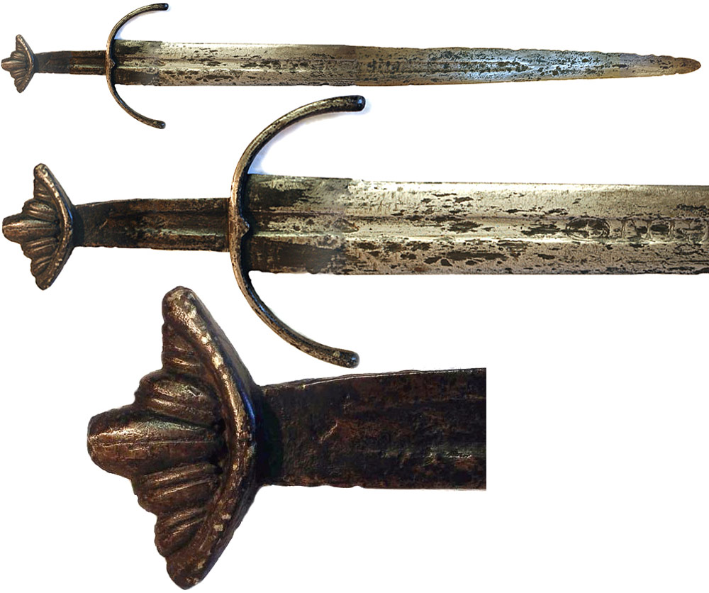

Last week I was at the yorkshire museum to document the cawood sword. Things went wrong because the asistant curator supposed to take care of us was off sick and we just got to see it in it's enclosure (which is very well made and allows for decent photography from most angles, with adequate lightning confition).
It's no match for hands on examination, but I noticed a few details of interest:
the pommel is hollow (at least the tang slot is very wide) as corrosion around the raised pattern of the pommel reveals (you can just barely see it on the close pommel shot below, two holes at the bottom).
there seems to be evidence of brazing/welding on the guard at the top junction with the tang.
Here are some of the shots I took. Enjoy!
ps: I could not get the insription on the blade despite all efforts...too bad we could not get closer indeed!)

I got to examine and handle the sword in 2008, and there are a few things to note. The sword was heavily cleaned by someone before the museum got it, so there could be a lot of things "done" to it. For example, the blade is likely a bit lighter than when it was forged. I also felt that the cross was glued in place (I assume by a previous owner), as there is a large gap otherwise - possibly due to corrosion; it did not look like brazing to me.
The pommel is also very thin and light, so I doubt it would be hollow.
