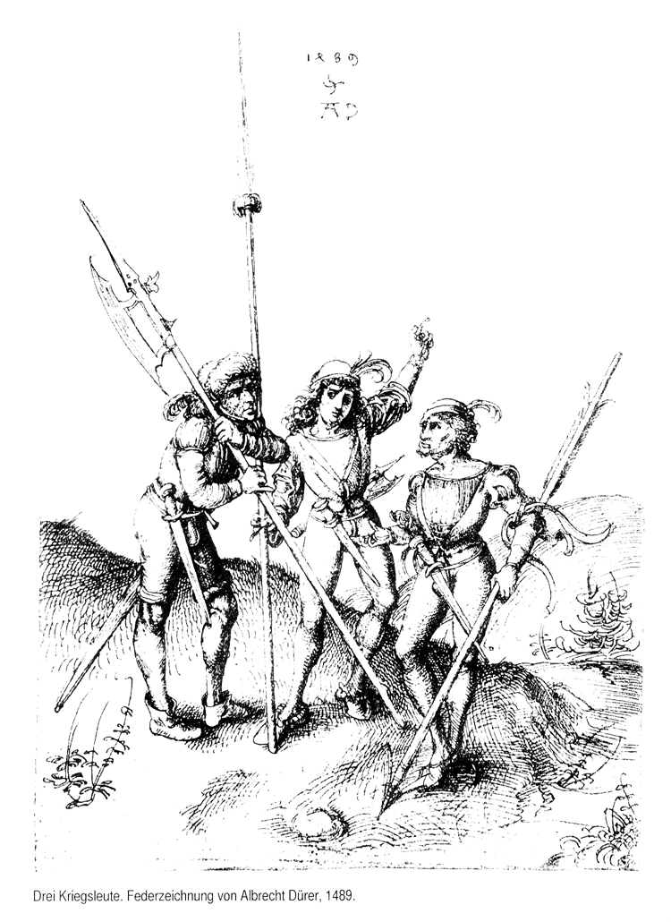

PostPosted: Fri 15 Oct, 2010 10:32 pm    Post subject: Re: Extremely long daggers         Reply with quote
Chad Arnow wrote:
Is there any evidence (pictorial or otherwise) for the use of these by people who would also be armed with a sword?
Albrecht Dürer, Drei Kreigsleute, 1489, has three soldiers armed with ELDs. One has a sword as well (and a polearm as his primary weapon).
 Attachment: 50.82 KB
Drei Kriegsleute, Dürer

PostPosted: Fri 15 Oct, 2010 11:59 pm    Post subject:         Reply with quote
Here is a bit bigger version of Dürer's drawing, looks like the soldiers are carrying rondels:
http://www.aisenbrey-auenwald.de/images/kriegsleute.gif
