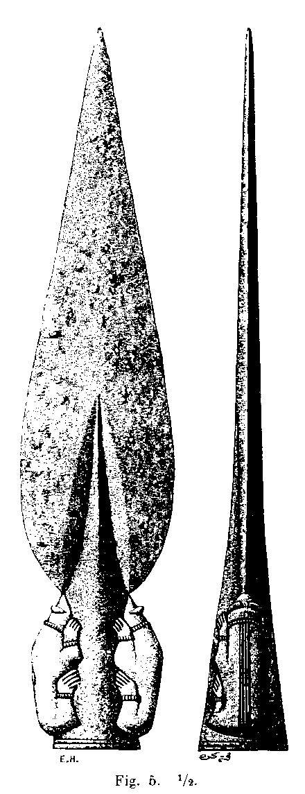

There are some finds of the type of spear head showed on these helmet plates.
The little bulbous things are crouching animals. I have seen bears (when prowling around in store rooms), but they may be other animals represented in finds as well. I don´t know.
I am of the opinion that the strap is a loop to help in throwing. Several spear shafts in Danish bog finds have tacks to secure such loops or even the loops themselves remaining. These spear shafts are one or two centuries earlier, but I think it is pretty safe to bet it is what is depicted in these images.
Below I attach a drawing of a find from Vendel grave XII:

Big Grin I have saved some pics of that spear Peter shows, lets see if it works now to Big Grin
seems work well, some can be copys of other pictures whit just a other angle Cool
more will come!

part 2 of that spear, and some yada yada so i can post them to Big Grin
that was all i have about that one, enjoy!

Patrik Erik Lars Lindblom
Location: Göteborg Sweden
Joined: 07 Jul 2004
Reading list: 8 books
Posts: 411
PostPosted: Sun 08 Aug, 2010 7:20 am    Post subject:         Reply with quote
Timo Nieminen wrote:
Thanks for the info and pics.
Spear-bears! (I might have said spear-moles without bears being mentioned.)
I just give those pics a name, Mole/Mullvad can it be to, strange animal who diging around underground
and make small hills/högar and still mess around with ouer farmers.
Matt, Stephenson's drawing follows the one you posted closely. I don't know what to make of the ones in Underwood; the "straps" stick up by themselves - must be quite stiff.
Thanks to Matt, that pic gives some new light on those spears, i belived that was a part of the shirt first,
make an big U of lether and fold it around the pole and sew them together and they are stiff. Big Grin

The last spear head posted, i belive that is this one whit bronze buttons,
or killer snails/ mördarsniglar Big Grin
http://mis.historiska.se/mis/sok/bild.asp?uid=225361
here are more spear heads to see, 57 pages only.
http://mis.historiska.se/mis/sok/resultat_bil...6&page
