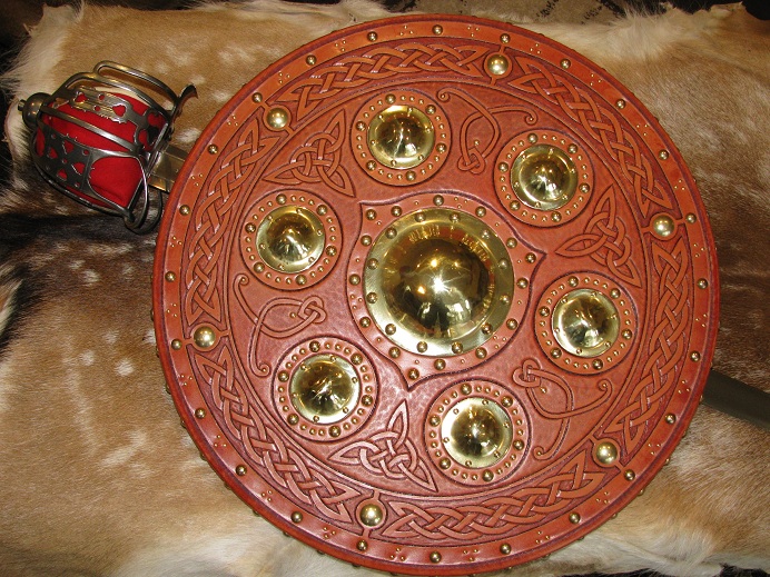

Hi all,
I've just finished my first shield, a highland targe.
The front leather is 4mm thick, over a 12mm plywood core. The back is covered with Red deer hide. I shot and skinned the deer, and tanned it's hide myself. It's padded with wool straight from the sheep's back. The center boss and 6 smaller domes I beat out of 2mm sheet brass using a couple of timber forms that I turned on my lathe.
I've never done any leather work before. The was a big learning curve with this project. I'm very pleased with how it turned out and it's given me confidence to tackle more leather projects now.

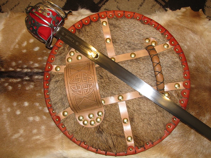

Here's the back of my targe

Hi Bruce,
your targe is very appealing. Really nice work. Well done!

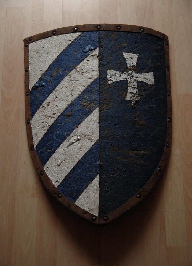

Here is my shield: He might be not the best looker but still is a great shield Happy
 Attachment: 245.96 KB
a little bit battleworn [ Download ]

Thanks Thomas, I've really enjoyed making it. I might try a new scabbard for the sword now.

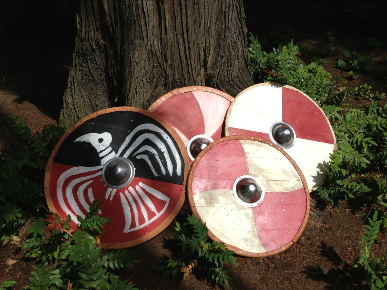

A few old ones I've made, working on some new ones more historically accurate right now.
